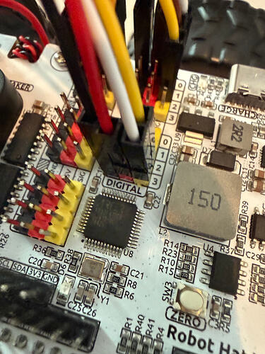

It is very likely that the ultrasonic sensor was connected incorrectly.
Could you please double-check the connections?
Black wire — GND
Red wire — 3V3
White wire — D3
Yellow wire — D2
After confirming the wiring is correct, please run the example code again to see how it works.

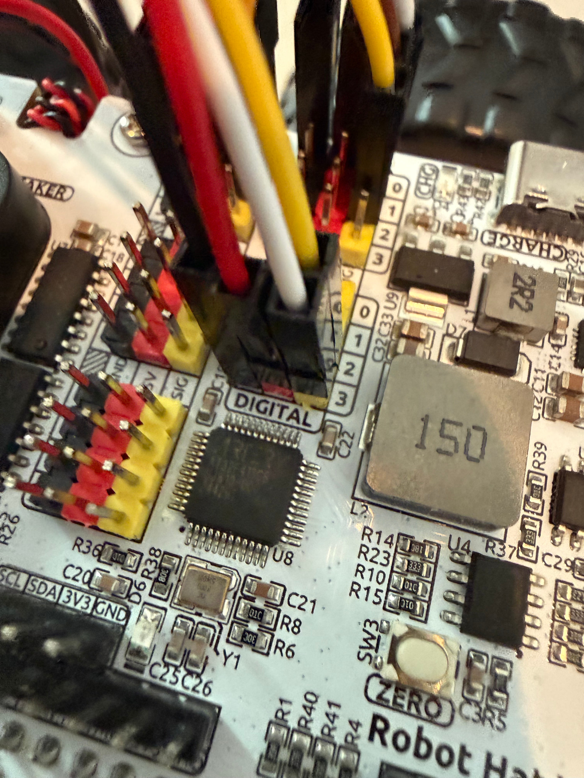

Obstacle Avoidance wire has no issue as enclosed picture
Black wire — GND
Red wire — 3V3
White wire — D3
Yellow wire — D2
same return -1 result, please assist to resolve the issue
