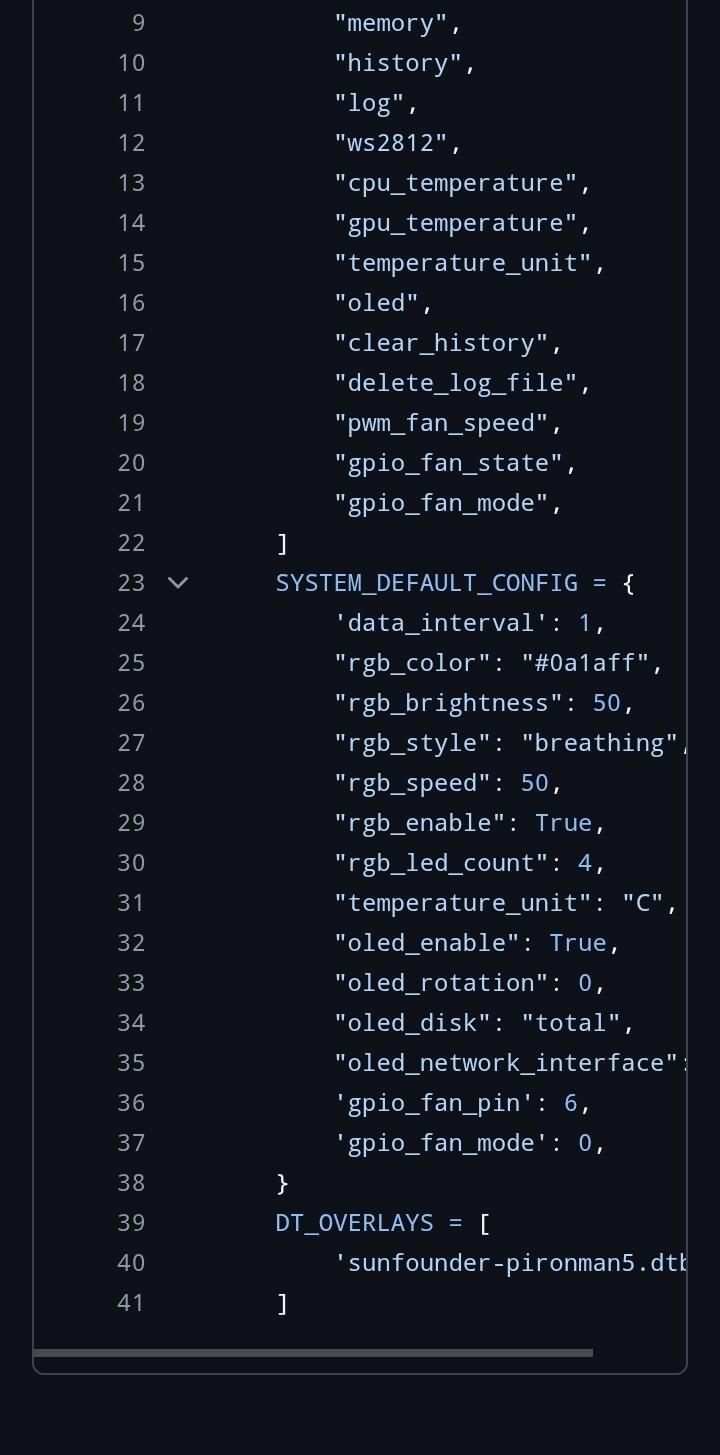

Acquire a 2nd pironman5 kit, this time it was the regular pironman5 kit.
The OLED is on all the time, it doesn’t turn off like my PIRONMAN5 MAX which will turn off after 5 seconds. How can I fix that….

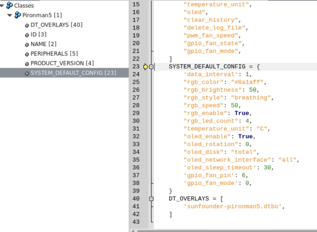

Thanks… added 30 seconds.
Does it really works? I wasn’t sure, guessing.
