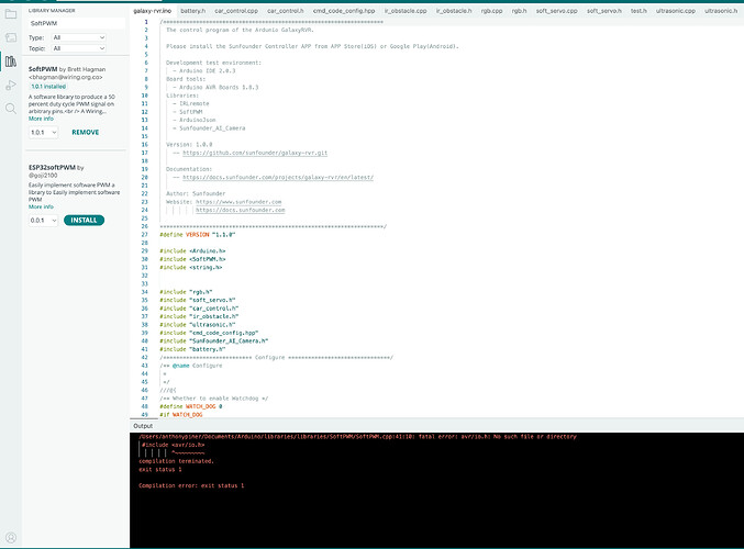

I have had the Galaxy Mars Robot running some time ago but when I tried to compile the sketch I get the error statement.
/Users/anthonypiner/Documents/Arduino/libraries/libraries/SoftPWM/SoftPWM.cpp:41:10: fatal error: avr/io.h: No such file or directory
#include <avr/io.h>
compilation terminated.
exit status 1
Compilation error: exit status 1
SoftPWM has been included in the libraries. This is running on an iMac with Arduino 2.3.6.

Hi
Thanks for your response.
I have downloaded the complete package again and re-installed the two libraries required with the same result. (See screen shot). I assumed that it was a missing something from a library but have not found any reference to an avr/io.h: call or file.

Essentially Arduino was still trying to compile for a previous board why I had been using (Arduino UNO R4) rather than an Arduino Uno AVR wifi board.
Once I had changed this the sketch now compiles.

Yes. Before uploading the code, you need to select the correct development board and the correct port number.
Our Mars rover is configured with an UNO R3 board, so please ensure you select the correct board and port. Refer to the screenshot.
