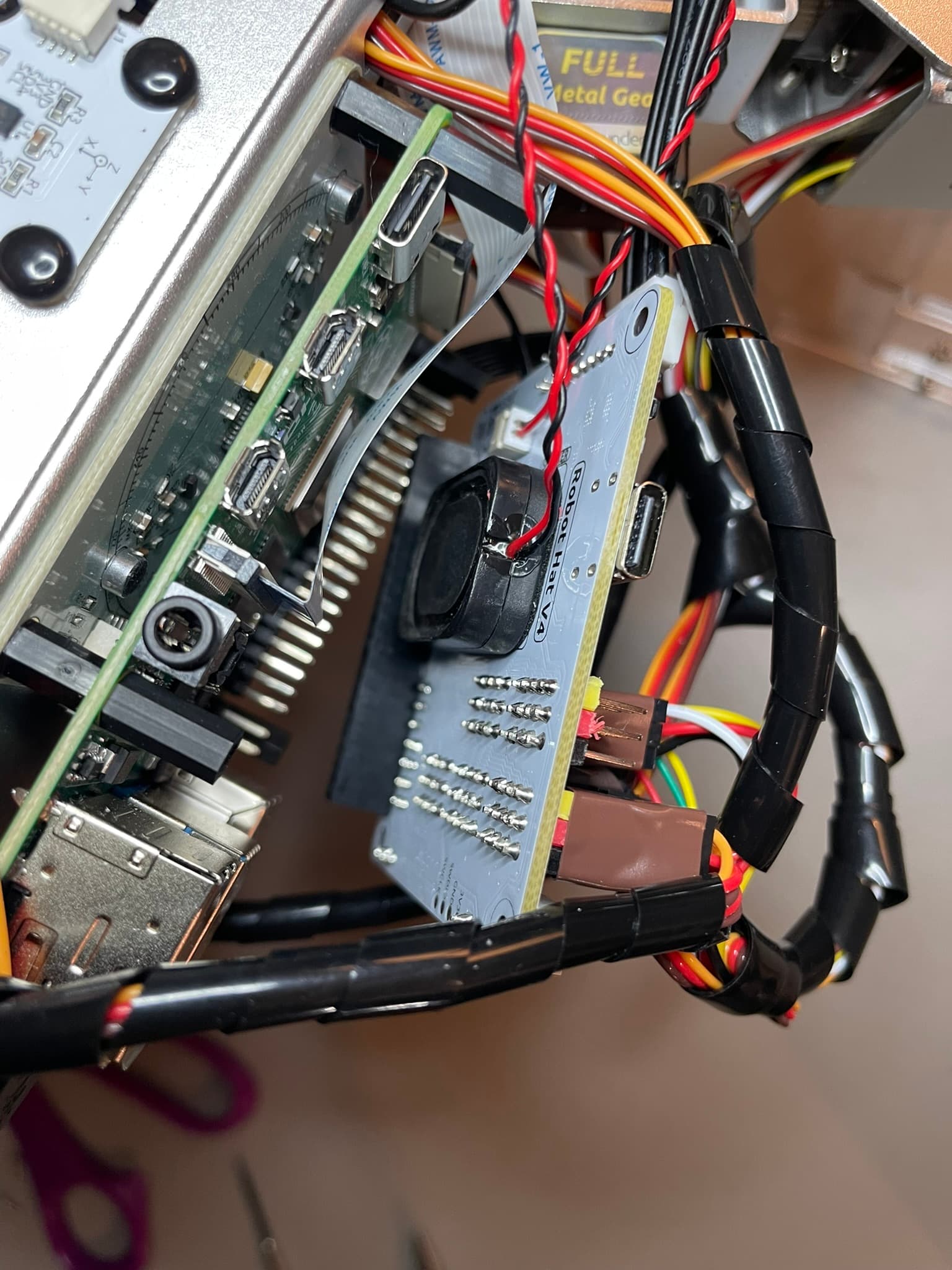

Thanks so much for the suggestion. I rebuilt a new SD card with the 6.6.51 system kernel and was successful in installing all the packages including Whisper. I was able to run an audio listening test and receive audio response a couple of times from ChatGPT. Unfortunately the audio output has stopped. Speach recognition still works but no sound comes out of the pidog nor are there any error messages. I tried rerunning the i2samp.sh configuration and test multiple times but without success. I saw in another post that there might be a problem with the speaker on the PiHat. I took the screws from the board and lifted it enough to take a picture of the speaker and it looked OK.
I think it must be a problem with the hardware on the Pidog Hat since I reinstalled the previous SD card that had good sound output and it does not work anymore either. Is there a warranty on the sound card hardware?
Please contact our after sales team at service@sunfounder.com
They will send you a replacement speaker.

Connecting the speakers is simple. Just connect the speaker connectors to the 2IPN holders on the back of the robot hat and tape the speakers in place.
Remove the old speakers. Unplug the wiring from the seat. Separate the speaker from the robot hat with the help of some hardware’s tools such as a one screwdriver, as they are taped with double sided tape.
