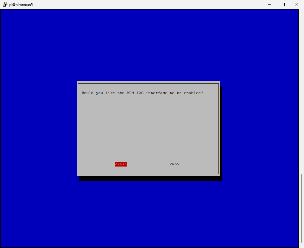

Attached error screenshot after executing the sudo ~/my_venv/bin/python3 gpt_dog.py --keyboard command.
This error should be caused by your i2c service is not enabled.
It is recommended that you execute the command sudo raspi-config, go to the settings page to enable the i2c service, and then go to run the example.
