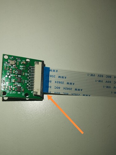

  3. I have checked ribbons three times. I NOTE on my cable, the blue side is NOT the side with printing on the cable… unlike your shots of construction videos. I have the blue strip facing the ports on the PI 4.0

1.Please check if your Raspberry Pi camera is properly connected and oriented correctly. (See the picture)
