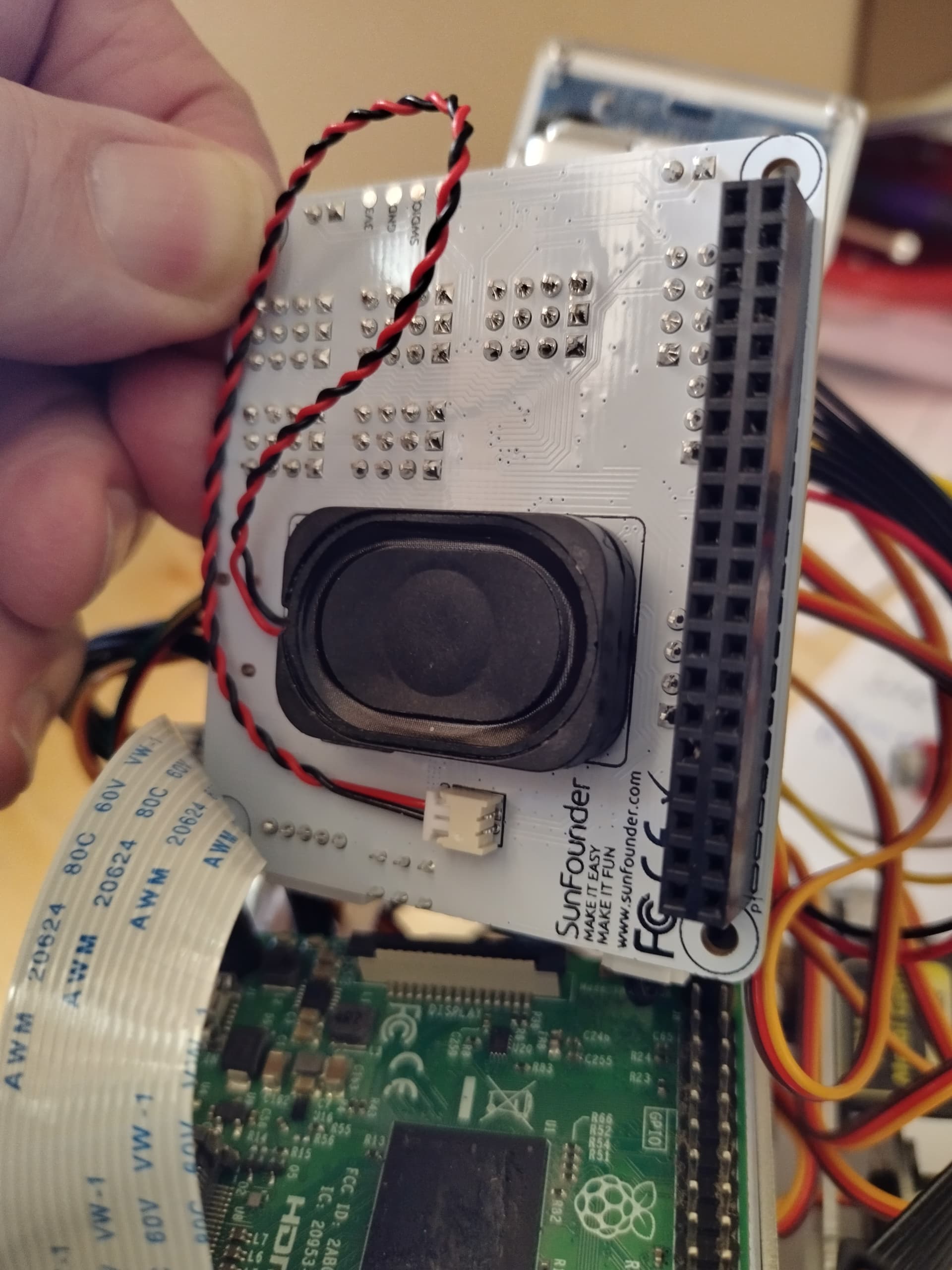

hi, I had the same problem. After reading this post I removed the heatsink from my RPi 3. Now I have sound but it isn’t very loud and more importantly it is distorted. I think maybe the speaker was damaged by the heat sink. What do I need to do to get another speaker?
Here is pic of speaker.
TIA, Paul
Please contact our after-sales team at service@sunfounder.com.
We will send you a replacement speaker.
