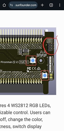

All seems to be ok, well connected, RGB fans are spinning but no LED, same for LED mounted on board. Pironman5 board is well connected to gpio, no bending, no pin damaged. Which OS are you using? All updates are done : sudo apt-get update && sudo apt full-upgrade -y and sudo rpi-update than reboot.
Have you set the FAN LED? We recommend you visit the dashboard and set the FAN LED to ON to enable it.
Fan LED: Set the RGB fan mode.
Off: Turn off RGB.
On: Turn on RGB.
Follow: Automatically turn on RGB based on the fan’s operating status.

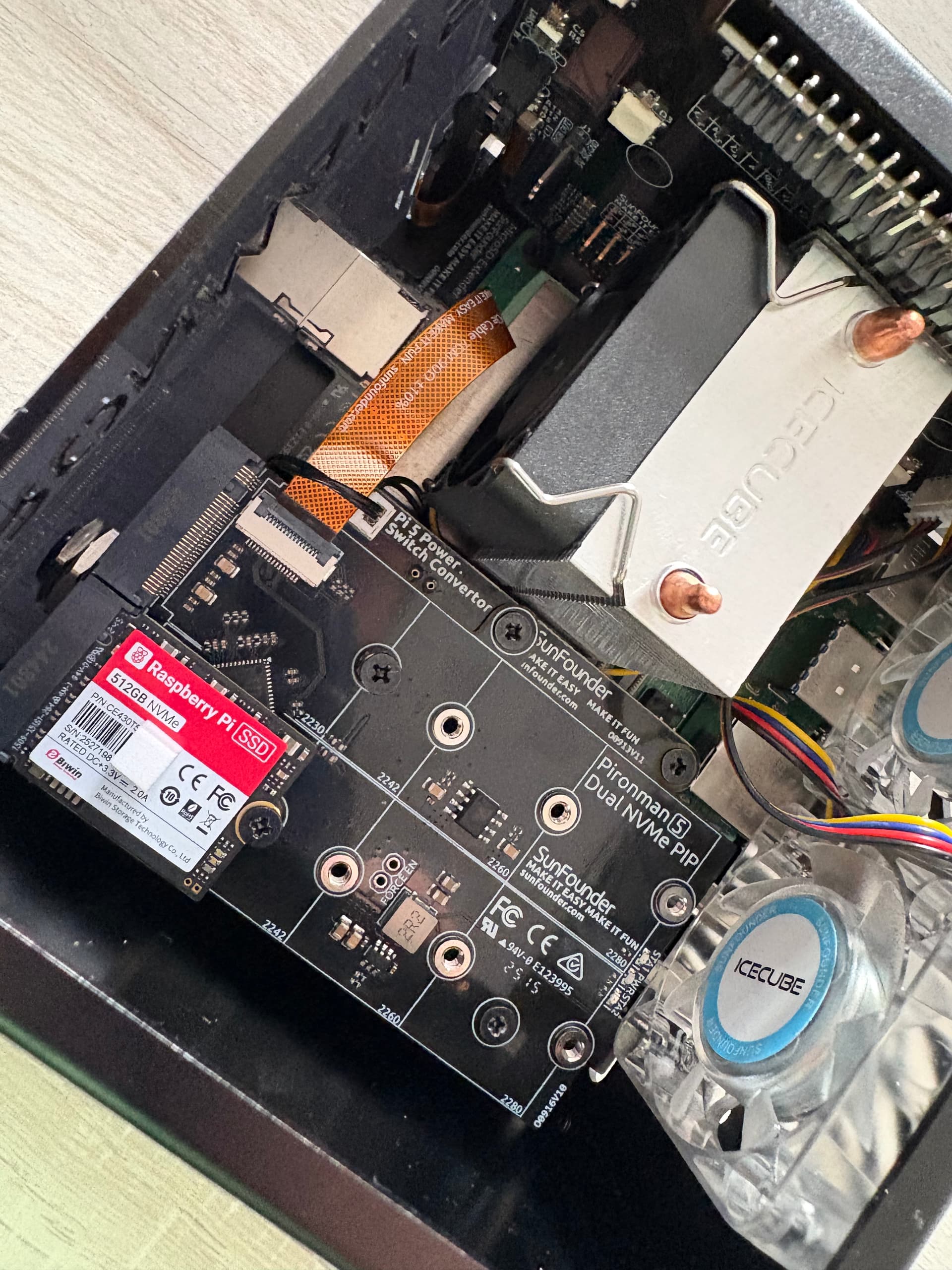

From the images you provided, we noticed that the wiring direction of the FPC cable for your dual NVMe PIP module may be incorrect. We suggest you carefully follow our FAQ tutorial to confirm this: [ FAQ — SunFounder Pironman 5 documentation ].
If the FPC cable direction is reversed, it may cause the dual NVMe PIP module to not receive power, leading to the SSD not being recognized or functioning properly.
Thanks for replying to my message. I have changed the FPC cable as described. Unfortunately with no result. So back to the beginning, removed the SD card, complete new image reloaded to the SD card. Fresh install, then from scratch started again:
