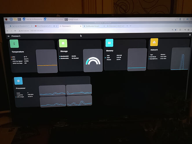

My piron max 5 is OK with a raspberry pi 5 16 Go
I have installed the software… you can see the dashboard
But the oled doesn’t work and the RGB stay down.
I checked some test :
