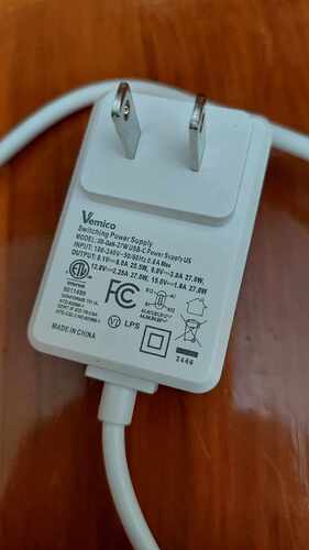

What is the specification of the power supply you are currently using? We recommend that you use the official PI5 power adapter to power the PI5.
What if you remove the Pi5 from the pironman5 chassis and use a power supply to power the PI5 alone to see if it powers up properly?
I have another vid using a different supply, also 5A x 5V.
