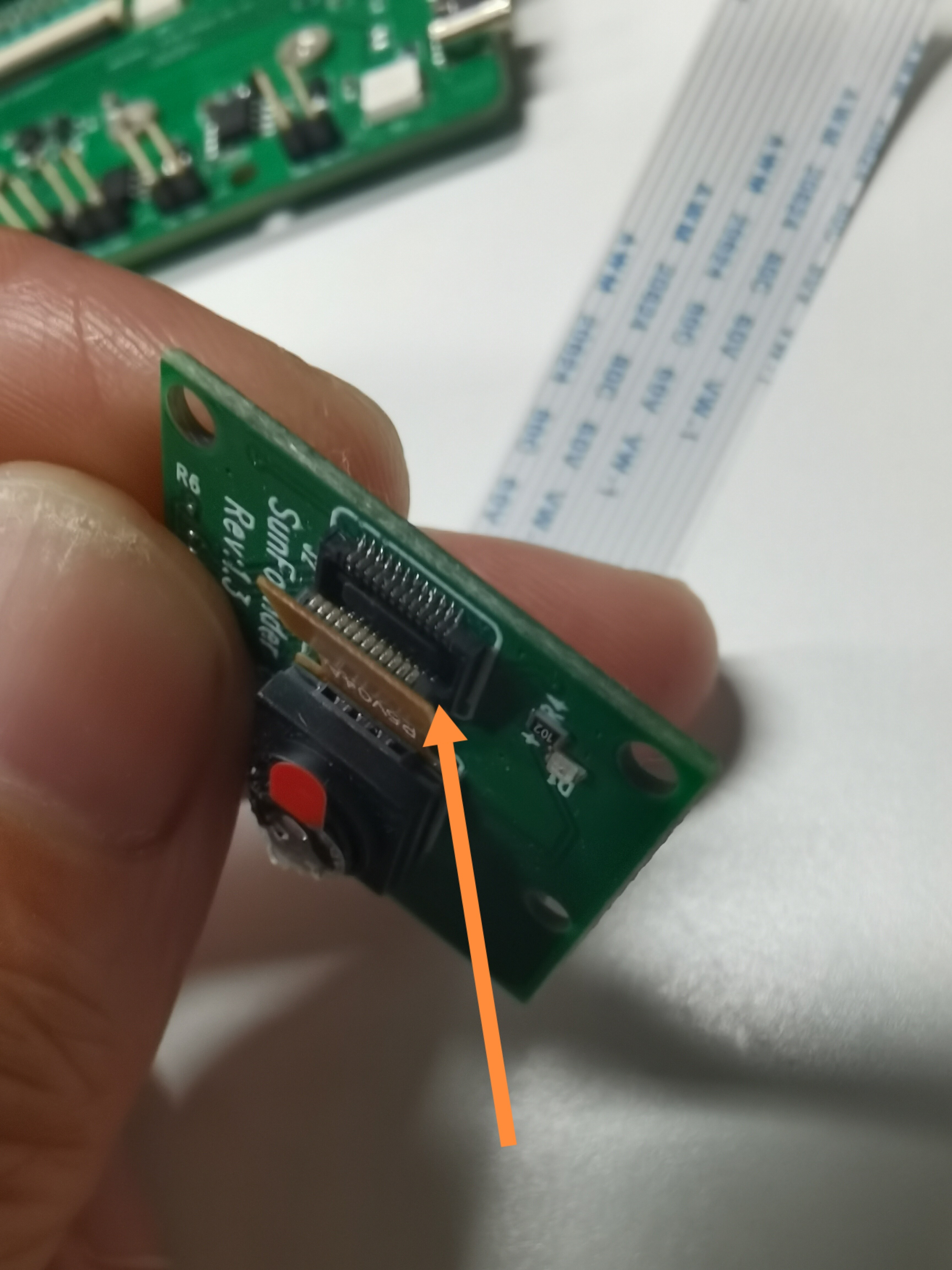

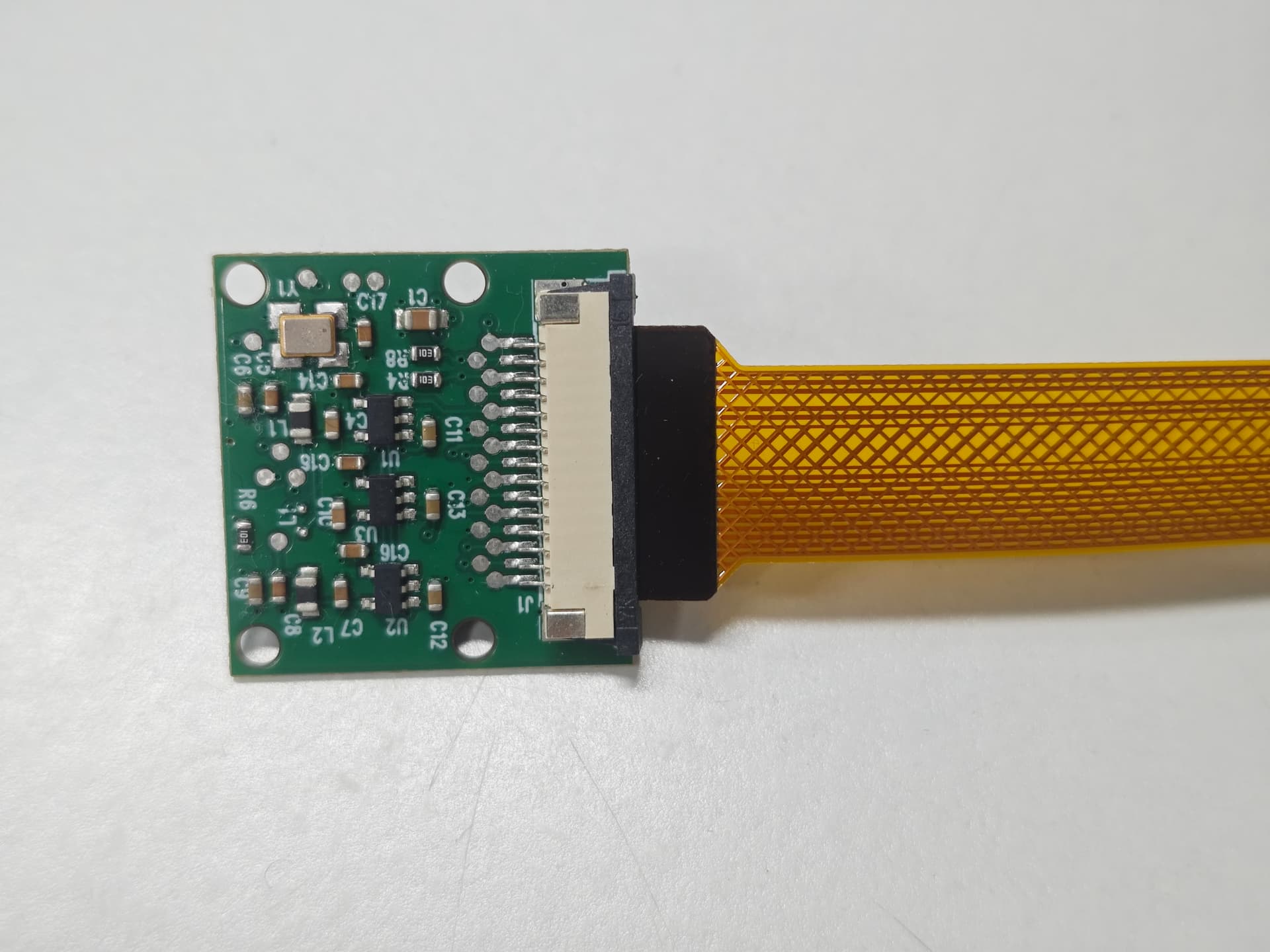

Please check if your camera FPC cable is securely connected (see the picture below).
We suggest reseating the camera cable and then running the rpicam-hello command to test if the camera can be detected.
