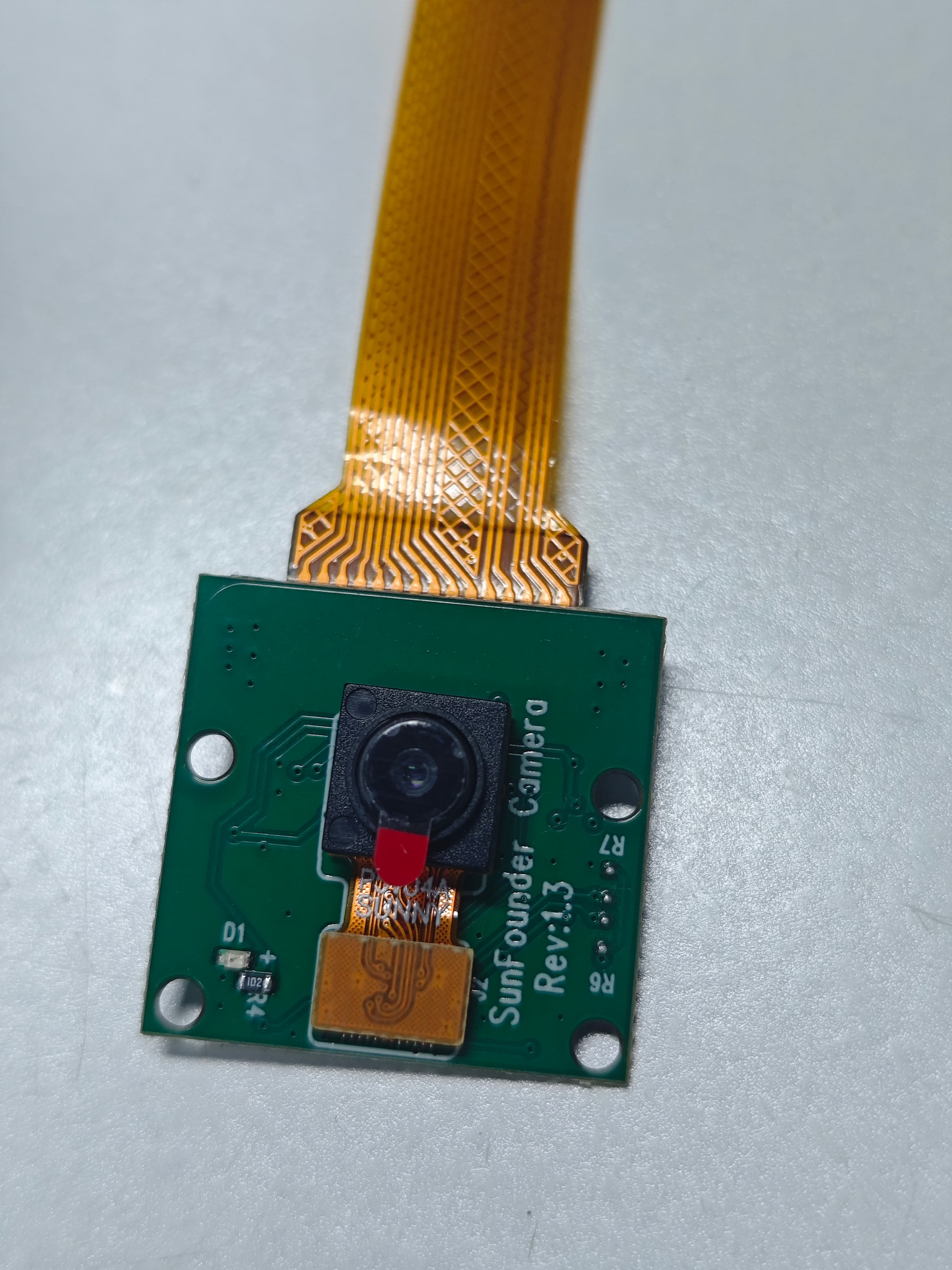

SO, I did redo all the hardware connections and got it working. Temporarily. A month ago, it stopped working again. I have repeatedly tried to adjust and redo the connectors. I am not sure what else to try.
Is there a way to directly buy a new camera module?
I see the SKU: cam003 - SunFounder Camera Module for Raspberry Pi 5/4/3B+/3B/Zero 2 w
But that isn’t the “AI Camera,” is it?
Please contact our after-sales email: service@sunfounder.com
The after-sales team will resend you a new camera module to see if it can solve your problem.
