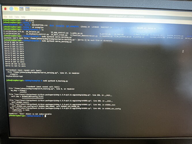

I have completed assembly of PiDog, and run the software as required to zero servos. However, now when I run any of the example or test programs, the program fails with a Type Error message. Here is photo of screen:
    ![IMG_1005|690x305](upload://mXbxdUlhkzjdIZ2lMheGTh4rwDU.jpeg)
I have reloaded the software, but get the same answer. Would appreciate help

I don’t see an error message, just the start of a traceback towards some possible error. I.e at first glance it looks like it wants to run further but was stopped by ctrl-c
Just a few questions to try to establish some context..
Was the code just hanging? Did you hit ctrl-c or similar to stop the hanging, or did it stop of it’s own accord?
If there are issues uploading photos, it’s probably better just to directly copy (SHIFT ctrl-c) the terminal content directly into the forum web page (ctrl-v)
Hello again ! In the previous screen shot, when I ran the program, it locked up, just showing a single character white block. I pressed C to escape.
I have tried again, first running servo_zeroing.py, which ran with no problem, then 9_howling.py, which gave the error message ending in ‘TypeError: ‘bool’ object is not subscriptable. This or similar is what I get if I run any of the example progs, apart from servo_zeroing.py
