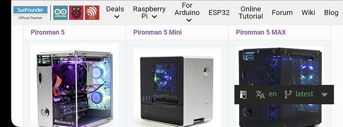

Ok, I was thinking that your problem was RGB fans still ON when pironman5 get OFF. Which model on pironman5 do you have? Standard, Mini or Max.
Just the Pironman 5 normal one. Sorry for the miscommunication. No, the issue is that the fans RGB LEDs are not controllable when the fans are on. As soon as I turn the fans off over the web dashboard the RGB colors also turn off and the fans also turn off when the case is turned off ![]()
