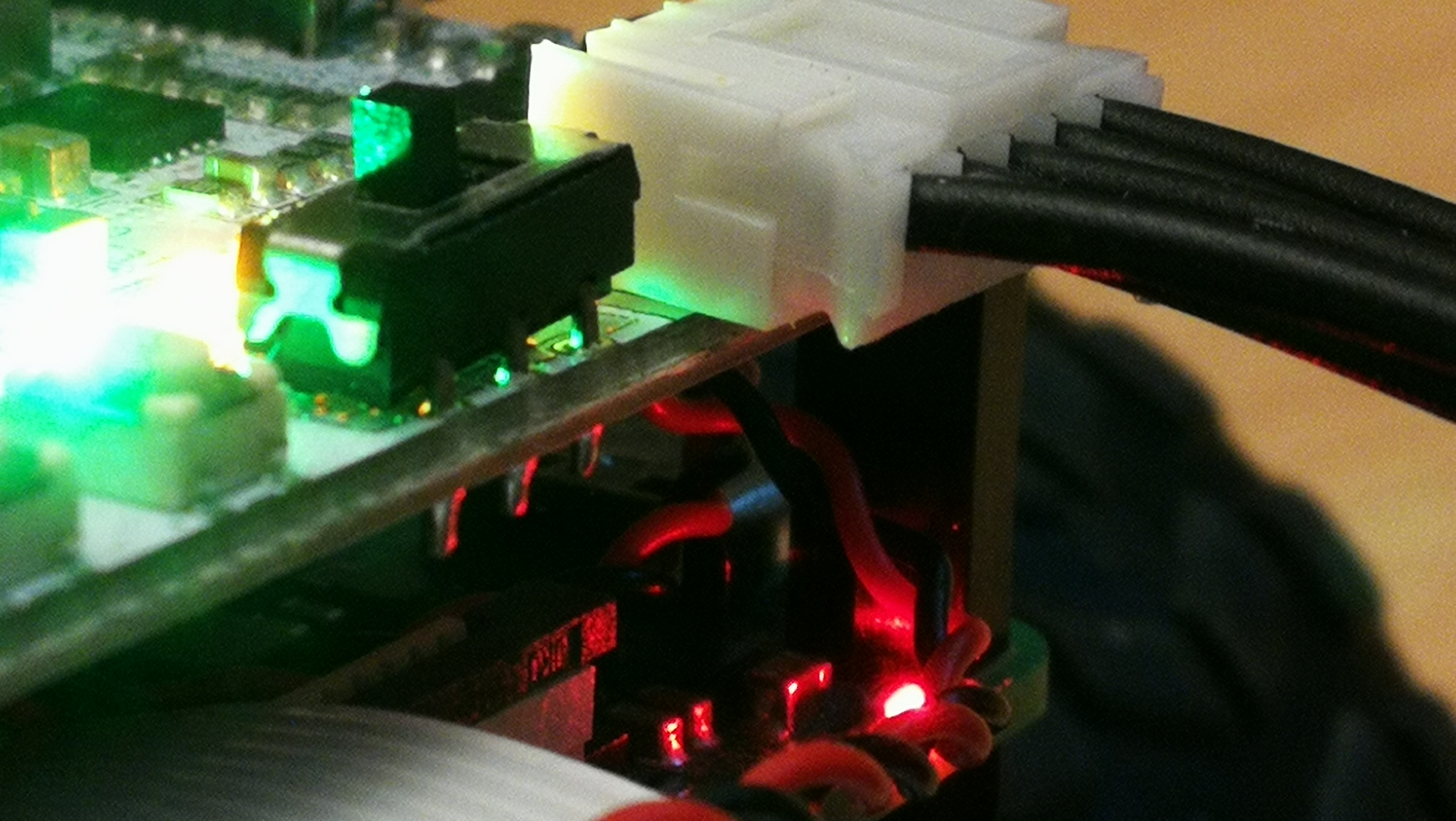

Hello to the developers,
I have a problem with the on/off switch of the RobotHat on the PiCar-X. It doesn’t switch anymore.How can I repair it?
Which poles need to be connected/disconnected so that I can switch the PiCar-X on and off?
otherwise the battery will discharge too quickly.

Are all 9 robot hats experiencing the same issue, or is it just one of them?
Could you please provide us with a video of the problem?
If the issue is with the sliding switch, we will send you a replacement robot hat.
Hallo to Sunfounder !!!
Here I am sending you a photo and a short film. The switch only works when it is pressed, not when it is switched. So far we have only built 2 PiCar-X. The second one has the switch installed correctly and works without any problems.
I would be happy if you could send me a replacement part.

Please contact at service@sunfounder.com.We will send you a robot hat.
