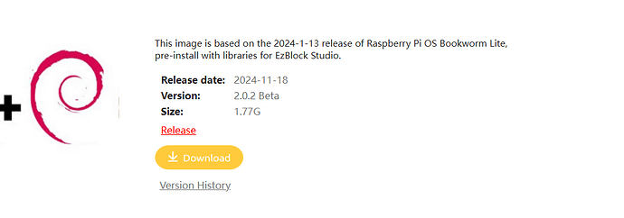

You can also try to download and install our 2.0.2 beta version of ezblock OS, and then connect to work and see how it works.
