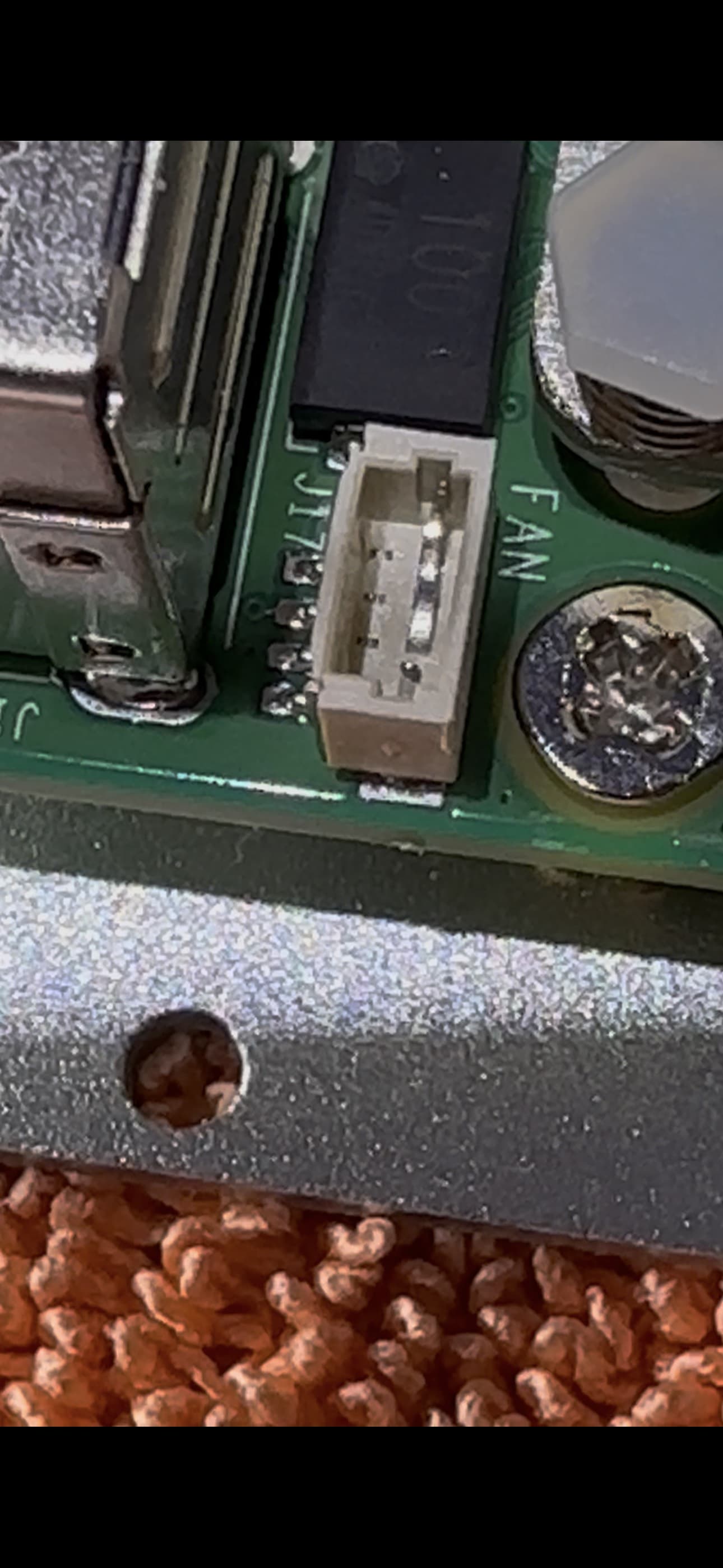

Please also check whether the pins of the Pi 5’s fan interface are properly aligned and connected to the heatsink connector.
Some users have encountered bent pins on the Pi 5’s fan interface due to misalignment with the heatsink connector, which prevented the connection from being established. Without a proper connection to the heatsink connector, the cooling fan will definitely not work.
Please refer to the attached image for clarification.
