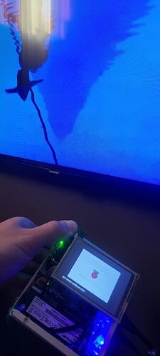

Same for me, I was so confused, I didn’t see you have 3.5 inches display. I can try it by my side, I have one 3.5 display on his box. I’ll try with my rpi4 mounted with pironman v2.
I confirmed, I made a new installation of bookworm 64 desktop, install 3.5 display drivers, plug the little display, it still on boot screen
With normal display on my TV and there’s no speaker icon.
So if you want to get any audio on your device, and because there’s no 3.5mm Jack, the only way to get sound is Bluetooth speakers or maybe usb-to-jack adaptor if it exists. Or if your tv have Bluetooth…
When I disconnect HDMI and boot it, that’s what I got.
