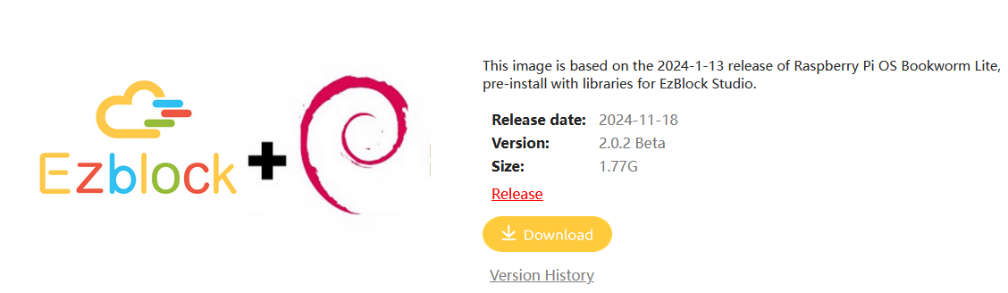

I am using the below OS, its the only one that worked for me on Raspberry Pi 5. The normal raspberry OS from the Imager does not work with EZBlock

Also the camera is extremely laggy, after testing it seems like its cause the bookworm lite OS doesnt use GPU only cpu, so the latency becomes unacceptable..but the sound works
have given up on eazyblocks, movement works if i code in python only, so i will just use that. Sound worked on bookworm lite, but camera latency was terrible, so im going back to the normal 64bit raspberry pi OS with desktop and will then try and fix the sound after that. Hopefully this fully fledged OS will fix the camera as well
