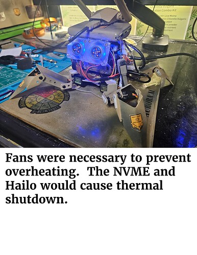

I have been trying to upgrade the original Sunfounder PiCrawler robot. I have been able to put in a Pi5 16gb, a POE hat for programming, a Hailo AI hat for AI object detection, a louder speaker, a usb wifi 6 module, and a i2c OLED screen to displey “eye” motions like Eva from Wall-e. I have the code if anyone wants, but I’m at a roadblock. My code will let you FPV from the picrawler, controlling it manually from the WSAD keys while streaming video via VNC. The usb Wifi gives me a range of about 30 meters.

Power isn’t an issue, I made a distributed power grid. And when not being a robot, it runs a full Desktop OS. Mods definatly void the warranty though. Using a level shifter and relay to supply power to the servos from a larger battery. Pi zero with sense hat gives gyro,accel,etc. and has it’s own battery too. So the robot has 3 separate power sources. Gets a little hot, so the pi zero also controls 2x 40mm fans.
A 3rd custom power distro pcb powers spotlights and fans.
