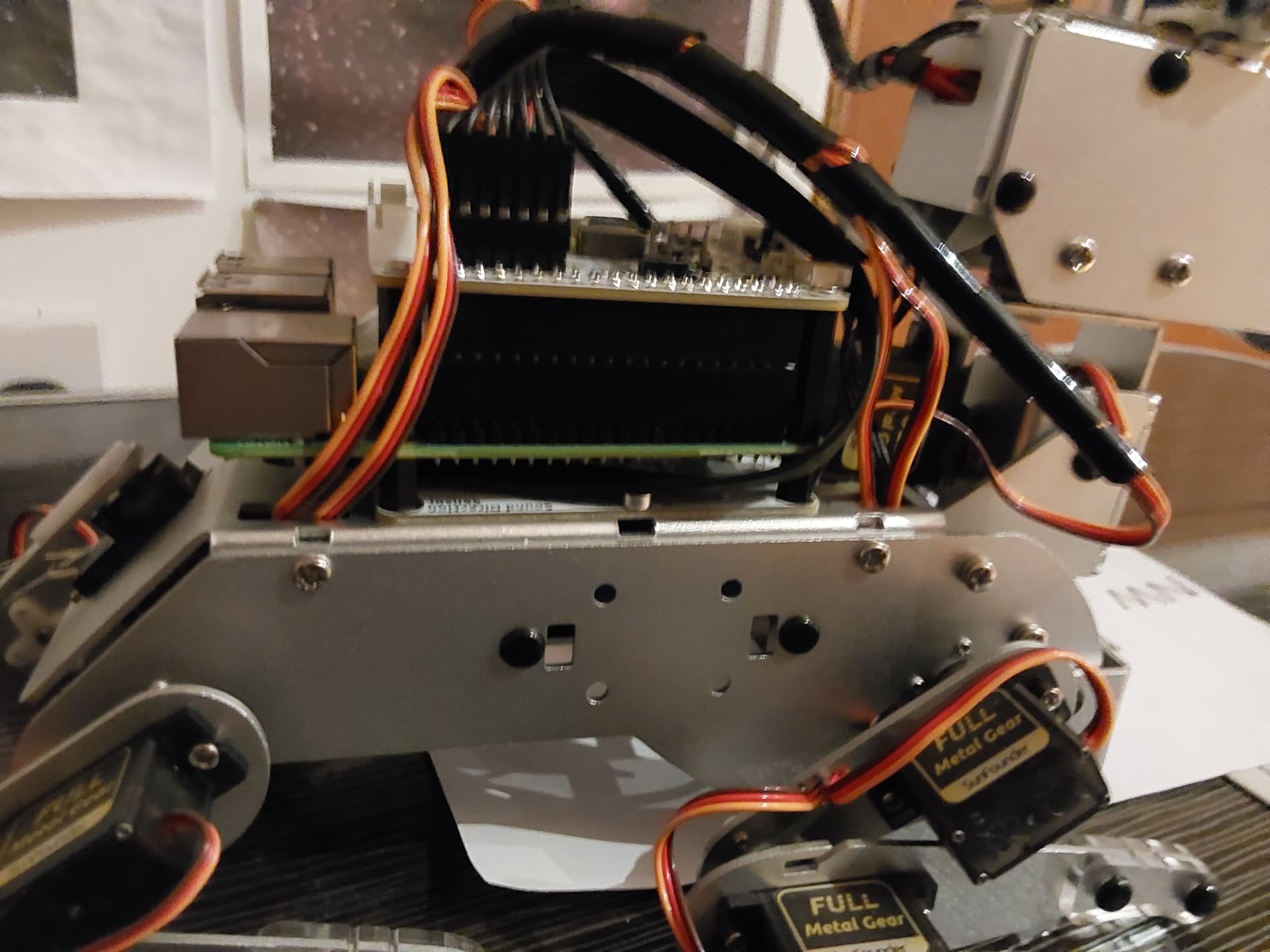

I was just wondering now I’m trying to check what is going on.
With the Wake Up test for example. I noticed that the head of the dog is going pretty far backwards and now it looks that it bumps into the cable from the battery connection on the hat. I had to elevate of course the hat due to the cooler mounting. Is it possible that when this servo is getting bumped here it pulls an amps spike and this triggers the shut down as protection ? Of course this still doesn’t explain the Low Voltage warning on my pi desktop running the other test were nothing bumps against anything.

Yes, eventually it came down to removing the active cooling as well. It is still tricky though. The power distribution is very on the edge of working or not working.
