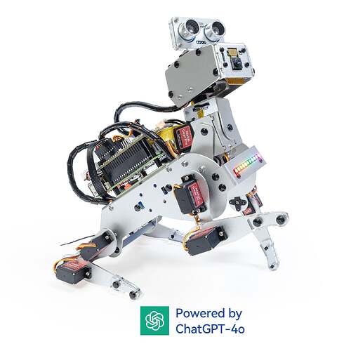

Hello my fellow PiDog friends!
I recently made a purchase and I’m a bit confused here,I figured I’d ask the community.
The purchase made was this PiDog PiDog
Then I see this one on Sunfounder
PiDog Pi5
My question is are they now compatible with the raspberry pie 5?
The title states " SunFounder PiDog AI Robot Dog Kit for Raspberry Pi 5/4/3B+/3B/Zero 2W, ChatGPT-4o Enabled with Voice Command & Video Recognition"
But on the bottom it says :
I would like to run a raspberry pie 5 for the most modern updates and capabilities.
Any input helps.
Thank you for reaching out to us with your question!
The PiDog kit you purchased is the previous version, which is not compatible with Raspberry Pi 5. We’ve just released the new version (labeled “PiDog Pi5”) in the last few days.

That means there is now a Pi5 robot hat available?
Can we order separately as well?
Oh no, if this is the case I will be retuning the original PiDog 4 and getting the PiDog 5
To avoid confusion, can you please drop a link of where I can order the new and updated Pidog 5?
Or let me know how I can order it.
Thanks in advance!
Yes, the PiDog product compatible with Raspberry Pi 5 is now available on our official website: SunFounder PiDog AI Robot Dog Kit for Raspberry Pi 5/4/3B+/3B/Zero 2W, ChatGPT-4o Enabled with Voice Command & Video Recognition | SunFounder Currently, we do not sell a Robot HAT compatible with Pi 5, but it may be available in the future. For further updates, please contact our service team at service@sunfounder.com.

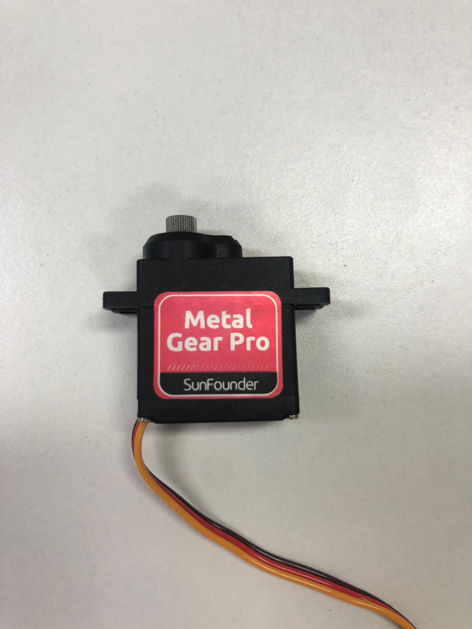

However, please note that the new version Pidog has upgraded servo motors compared to the previous version.

What’s the difference between the old and new servo versions? Just the “Pro” in the name? :slight_smile:

The new servo has better gear meshing, lower current consumption, and greater power.
is it possible to buy the better servos extra to use them in pidog V1?
If needed, you can purchase the servos from our PiDog V2 version separately to replace the ones in your PiDog V1.
The PiDog V2 servos feature improved gear meshing, which effectively helps prevent servo jitter.
Product Link:
I bought the new Pro-servos for the Pidog after I had problems with one of the original front-leg servos . I can confirm, they work more efficiently and smoothly on Pidog V1. Have fun, Robert
