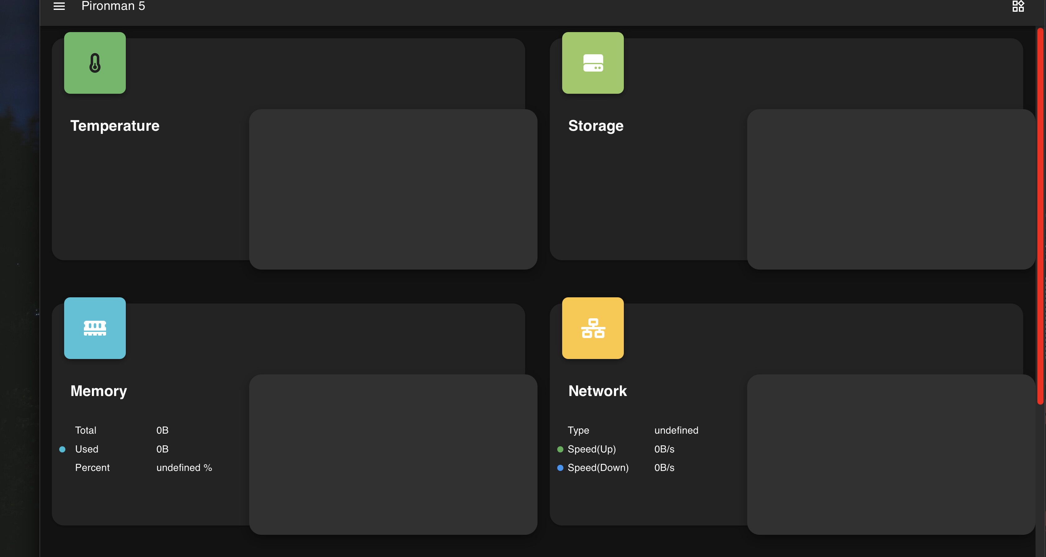

Pironman 5 dashboard not showing any detail can someone help me solve it.

After doing all the things error 404 poped up in the button and same blank scree appears. I went to pm dashboard logs and found this statment
â25/06/24 00:30:42.543 [ERROR] Failed to set data: {âerrorâ:ânot attempting to open shard 14; opening shard previously failed with: [shard 14] failed opening /var/lib/influxdb/data/pironman5/autogen/14/fields.idx: open /var/lib/influxdb/data/pironman5/autogen/14/fields.idx.tmp: permission deniedâ}â

Iâve noticed that the dashboard works sometimes and sometimes not. The other day, I checked it and it was not working. On a hunch, I cleared the history and it started again. Worked for a couple of days and stopped. Tried clearing the history again and this time it did not help. As of now, no dashboard data displayed. perhaps in the next release, it will be more stable. If I run sudo systemctl status pironman5 .service I get

unfortunately, that did not work. Updated to 1.2.17. Results are the same. Tried clearing the history (again) and that did nothing as well.
update:
Tried
- sudo service pironman5 stop
- sudo rm -fr /var/lib/influxdb/data/pironman5
- sudo rm -fr /var/lib/influxdb/wal/pironman5
- sudo service pironman5 start
Started working again. Is this something that just has to be done periodically?
