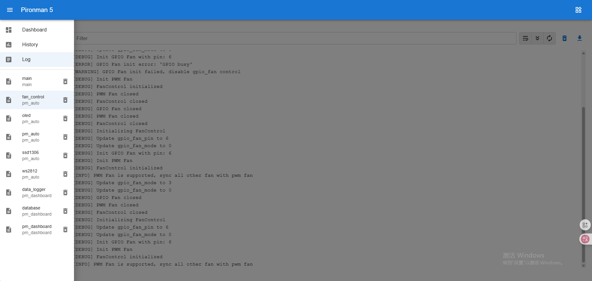

If someone have problems with not working RGB Fans / GPIO Fans, i found a decision

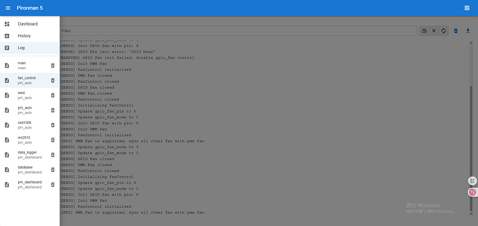

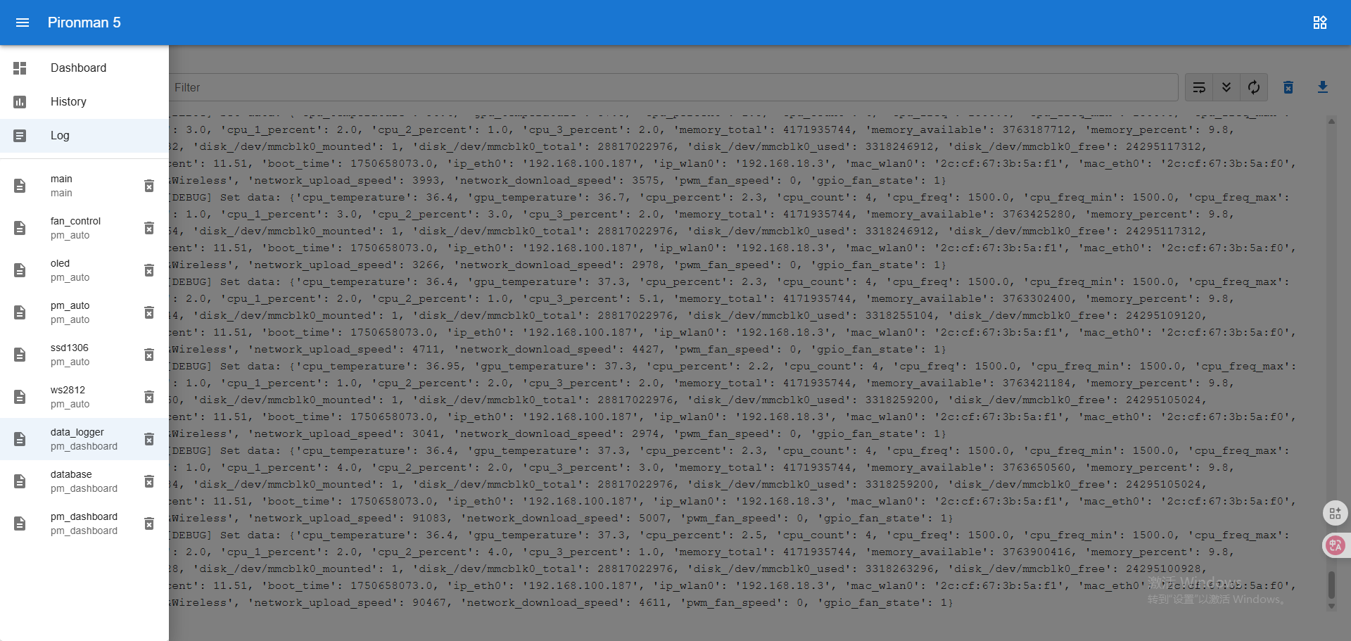

If you have these logs in fan_control
25/06/21 22:12:38.318 [ERROR] GPIO Fan init error: 'GPIO busy'
25/06/21 22:12:38.319 [WARNING] GPIO Fan init failed, disable gpio_fan control
You can create a service that will reserve the necessary fan pins before launching the pironman5 service, so they will work for you, but you will not be able to control them. But at least the cooling will work.

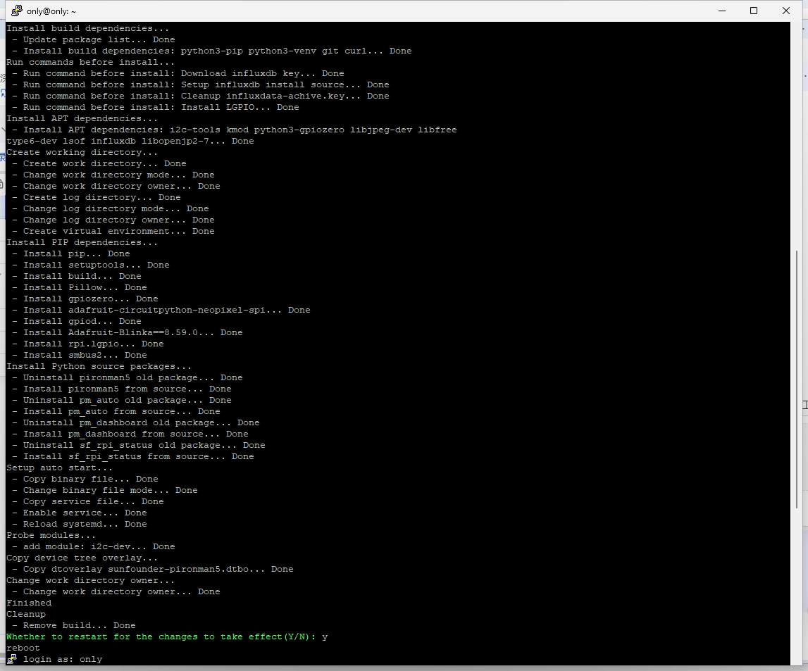

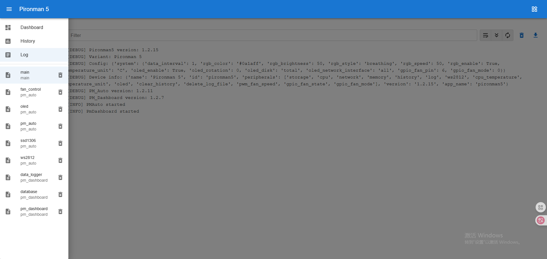

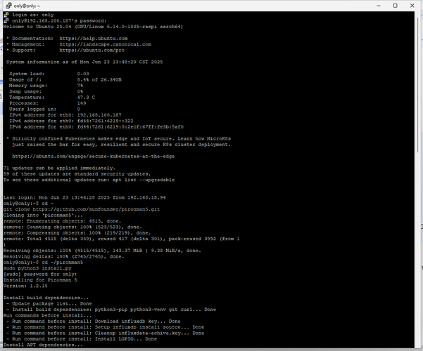

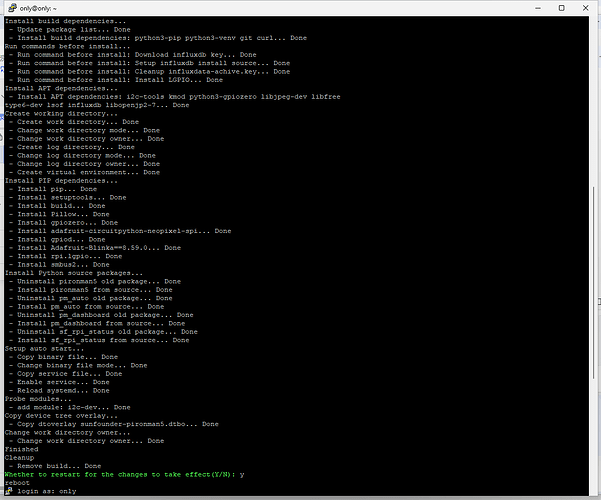

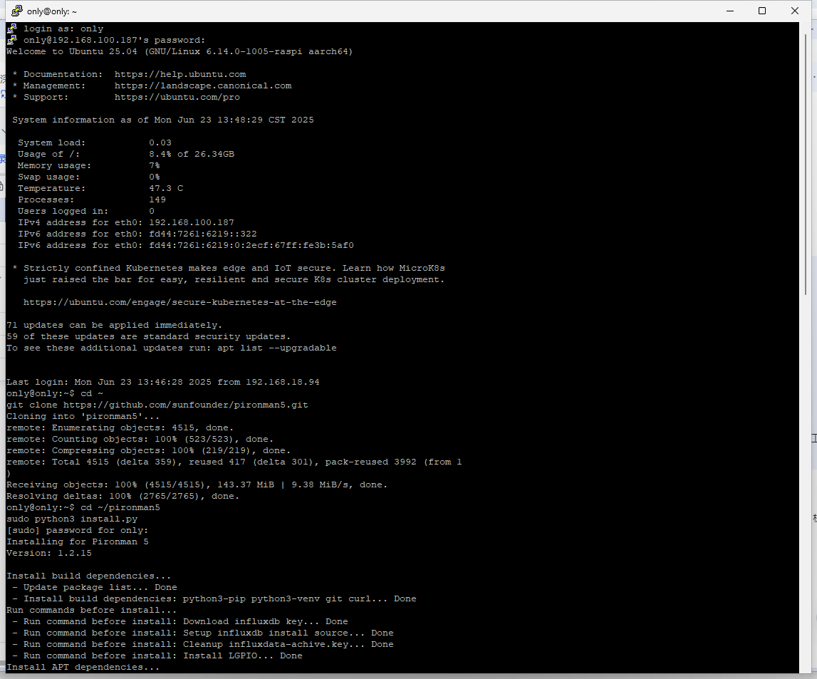

We conducted verification tests using the Ubuntu Server 25.04 system you provided, and the installation of the Pironman5 software was successful. All functions of the case are working as expected.
  1. Please confirm if there were any error messages during the installation of the Pironman5 software. If so, kindly provide screenshots of the errors for our analysis.
  2. Once you successfully install the Pironman5 software and start the system, the software will automatically launch without needing to manually start the service.
  3. We accessed the dashboard using Google Chrome.
  4. Is your RGB fan correctly connected to the FAN pins on the IO expansion board? The red wire should connect to the “+” terminal, and the black wire should connect to the “-” terminal.
  5. We recommend reinstalling the system and then installing the Pironman5 software to see if it resolves the issue. You may also choose another compatible system to verify the results.
If other users encounter this problem, they can follow MafiaCoconut’s solution to see if it resolves the issue. We have not been able to reproduce this problem; following the correct installation process for the Pironman5 software, all functions are working as expected.

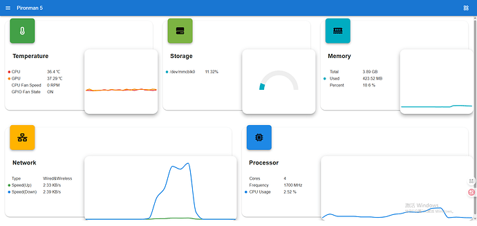

Je viens de tout réinstaller, avec ubuntu 25.04 desktop.
Les ventilateurs RGB fonctionne soit tout le temps soit jamais, il ne s’adaptent pas en fonction de la température, aucune info n’est apportées par les logs…
Merci de m’aider

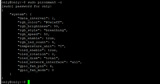

After successfully installing the software, the RGB fans are set to “Always On” by default. You can use commands to configure the operating modes of the two RGB fans. These modes determine the conditions under which the RGB fans will activate:
4: Quiet - The RGB fans will activate at 70°C.
3: Balanced - The RGB fans will activate at 67.5°C.
2: Cool - The RGB fans will activate at 60°C.
1: Performance - The RGB fans will activate at 50°C.
0: Always On - The RGB fans will remain on at all times.
For example:
sudo pironman5 -gm 3
https://docs.sunfounder.com/projects/pironman5/en/latest/pironman5/hardware/io_board.html#rgb-fan-pins
