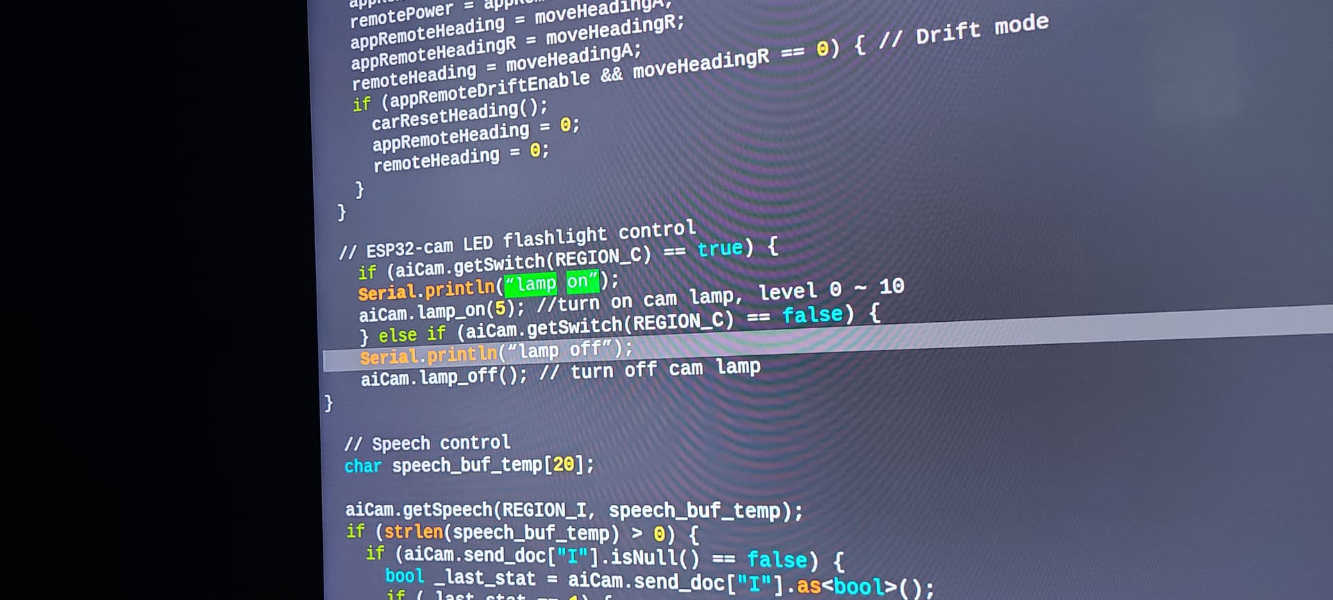

There’s photos of where I add codes
I’m sorry, I’m so newbie, even with ChatGPT, I’m turning in round. I really need a good book about coding, from newbie to pro… ![]()
What do you think about those instructions: Zeus Smart Car Kit: light and WiFi signal boost to explore the dark – Renzo Mischianti
Sorry, the lamp_on() function is not included in the aiCam class of Zeus Car, the correct code is located in another branch and that branch has separated ai_camera.h, ai_camera.cpp into a separate library. Anyway here is the correct way to do it:

Add lamp_on and lamp_off function definitions to ai_camera.h, ai_camera.cpp. - add in Zeus_Car.ino onRecive() function:
if (aiCam.getSwitch(REGION_C) == true) {
Serial.println(“lamp on”);
aiCam.lamp_on(5); //turn on cam lamp, level 0 ~ 10
} else if (aiCam.getSwitch(REGION_C) == false) {
Serial.println(“lamp off”);
aiCam.lamp_off(); // turn off cam lamp
Ok, thanks you for the photos, it’ll be easier for me to enter codes at the right place.

/home/david/Téléchargements/zeus-car-main/Zeus_Car/Zeus_Car.ino:158:34: warning: invalid conversion from ‘void ()()’ to 'void ()(char*, char*)’ [-fpermissive]
aiCam.setOnReceived(onReceive);
In file included from /home/david/Téléchargements/zeus-car-main/Zeus_Car/Zeus_Car.ino:40:0:
/home/david/Téléchargements/zeus-car-main/Zeus_Car/ai_camera.h:115:10: note: initializing argument 1 of ‘void AiCamera::setOnReceived(void ()(char, char*))’
void setOnReceived(void (func)(char, char*));
/home/david/Téléchargements/zeus-car-main/Zeus_Car/Zeus_Car.ino: In function ‘void modeHandler()’:
/home/david/Téléchargements/zeus-car-main/Zeus_Car/Zeus_Car.ino:295:5: warning: jump to case label [-fpermissive]
default:
/home/david/Téléchargements/zeus-car-main/Zeus_Car/Zeus_Car.ino:282:12: note: crosses initialization of ‘bool changed’
bool changed = compassCalibrateLoop();
/home/david/Téléchargements/zeus-car-main/Zeus_Car/Zeus_Car.ino: In function ‘void onReceive()’:
Zeus_Car:614:23: error: ‘lamp’ was not declared in this scope
/home/david/Téléchargements/zeus-car-main/Zeus_Car/Zeus_Car.ino:614:23: note: suggested alternative: ‘map’
map
Zeus_Car:617:23: error: ‘lamp’ was not declared in this scope
/home/david/Téléchargements/zeus-car-main/Zeus_Car/Zeus_Car.ino:617:23: note: suggested alternative: ‘map’
map
exit status 1
stray ‘\342’ in program
What am I doing wrong?
At least, can you made changes into the original codes, test it on a Zeus car, confirm that’s work and send me the files?
I have added CAM lamp control to the code. You can re-download the modified code from github GitHub - sunfounder/zeus-car: SunFounder FPV Omni Car for Arduino
It works, thanks you SOOOOOO MUCH. I think alot of persons will like this feature. ![]()
