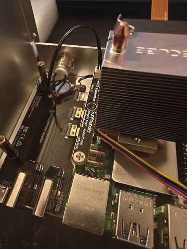

Just got my Pironman 5 case and when i was mounting everything I tried to place the camera but noticed that the “Power Switch Converter is just in the middle of the connector so i cant place it, so how am i supposed to connect this?

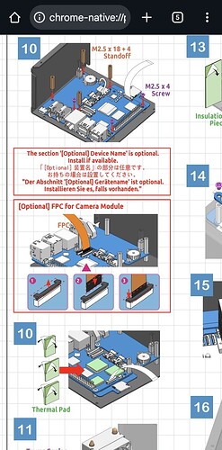

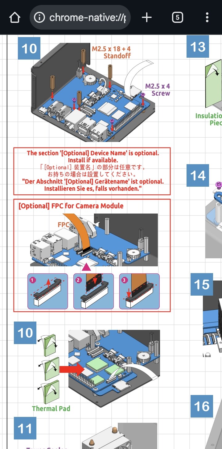

Hi, you can refer to pironman5 max assembly instructions. 2. Assembly Instructions — SunFounder Pironman 5 documentation
You’re right, the switch converter and standoff can interfere with the camera cable’s path.
Here are two workarounds:
Carefully route the cable by gently bending it around the standoff.
Some users have solved this by making a small cut in the switch converter to create a clean path for the cable.
