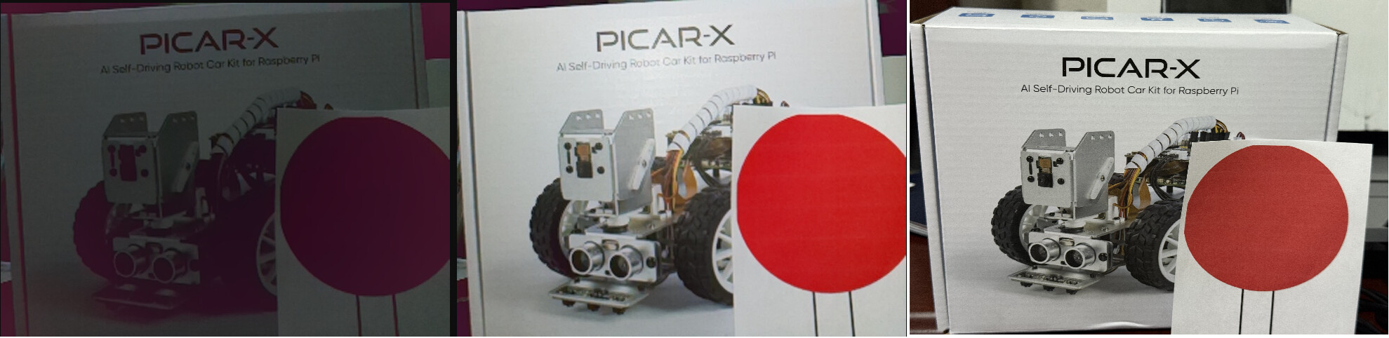

If I shine a light from behind the camera it sees them just fine, but without a light, it is too dark for any recognition of colors or objects. My house has a lot of natural light as well as lights, but the PiCar-X camera can barely function.
Left Pic is Pi-Car-X with normal room lighting
Middle Pic is Pi-Car-X with a flashlight
Right Pic is iPhone with normal room lighting

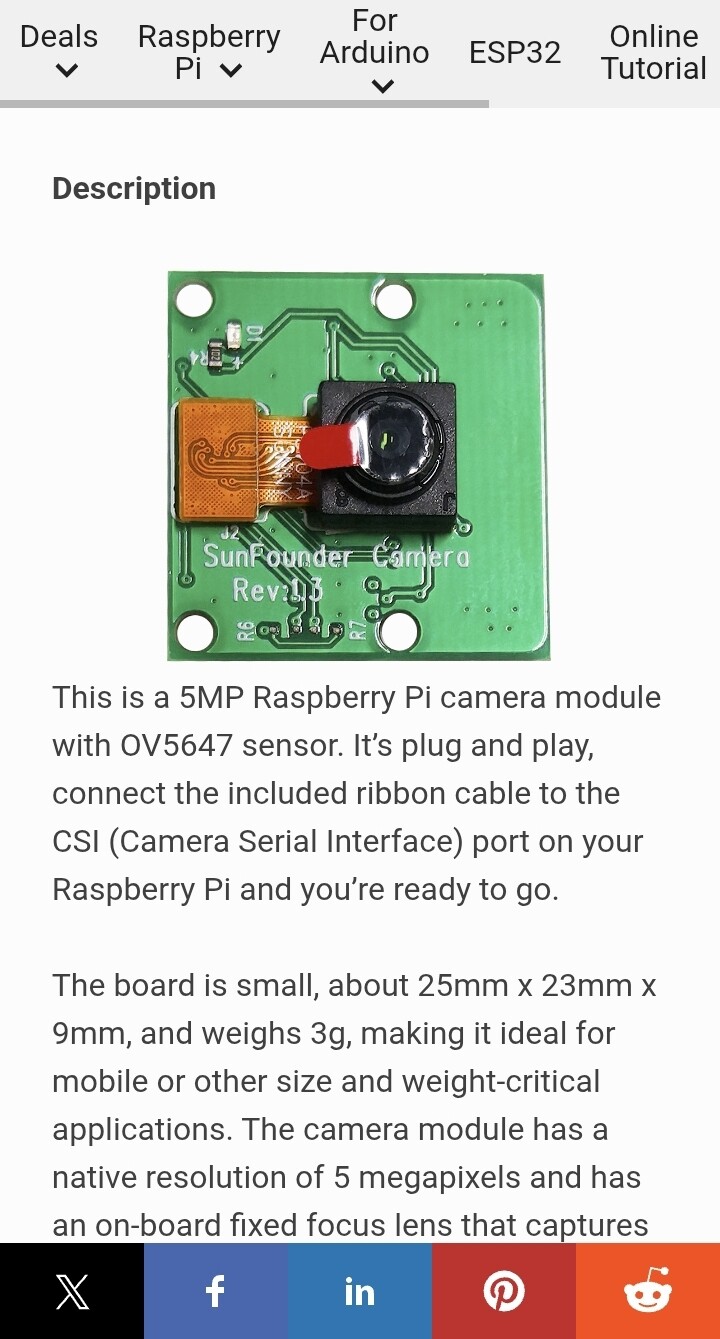

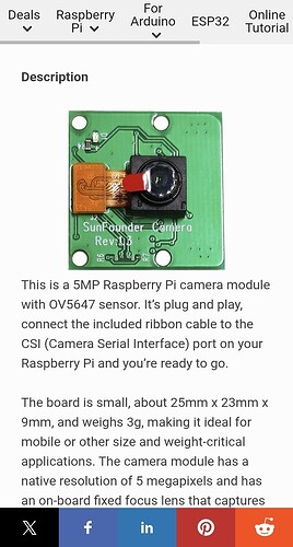

I think the PiCar-X includes the V1 2013 camera that was discontinued. I ordered a V2 and V3 which should be compatible with the same code to see if they work better.

I have tried that already, and nothing changes. As you can see the camera module displays great if I use a flashlight so I think all connections are fine.
