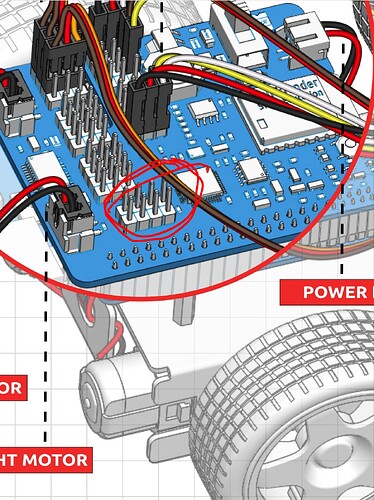

Hi, I’m not 100% sure as to your question. The robot hat is being detected, as your speaker tests etc work. As far as I know the picarx doesn’t have any i2c modules, so there’s nothing for the i2c detect command to find. Afaik It only has adc/pwm style controls. What exactly isn’t working?
Similarly the i2c connector in the build instructions is unpopulated
