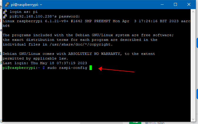

You should use ssh to connect to the ip remotely if you encounter this situation, or use the putty tool to connect to the IP.
Let’s use the putty tool to connect to the ip and execute sudo raspi-config to enter the setup page.
For the operation, please see our image at

After restarting the Raspberry Pi system, go to vnc and open the remote connection to see.
Thank you once again. Unfortunately, setting vnc resolution to 1024x768 did not solve the problem. If the camera is enabled via raspi-config, VNC shows the black screen with ‘Cannot currently show the desktop’. If I disable the camera in raspi-config, VNC works properly.
However, I did get it working properly with another method, so this is no longer a problem. Here is what I did:
