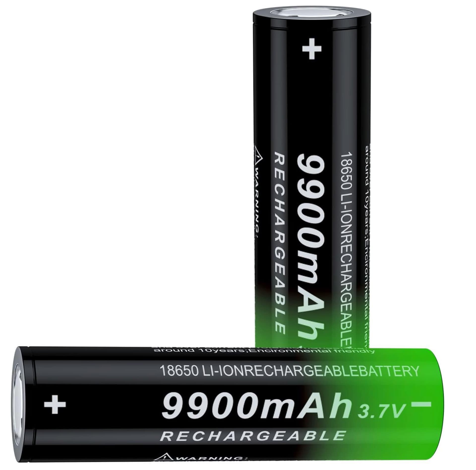

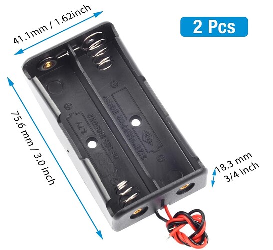

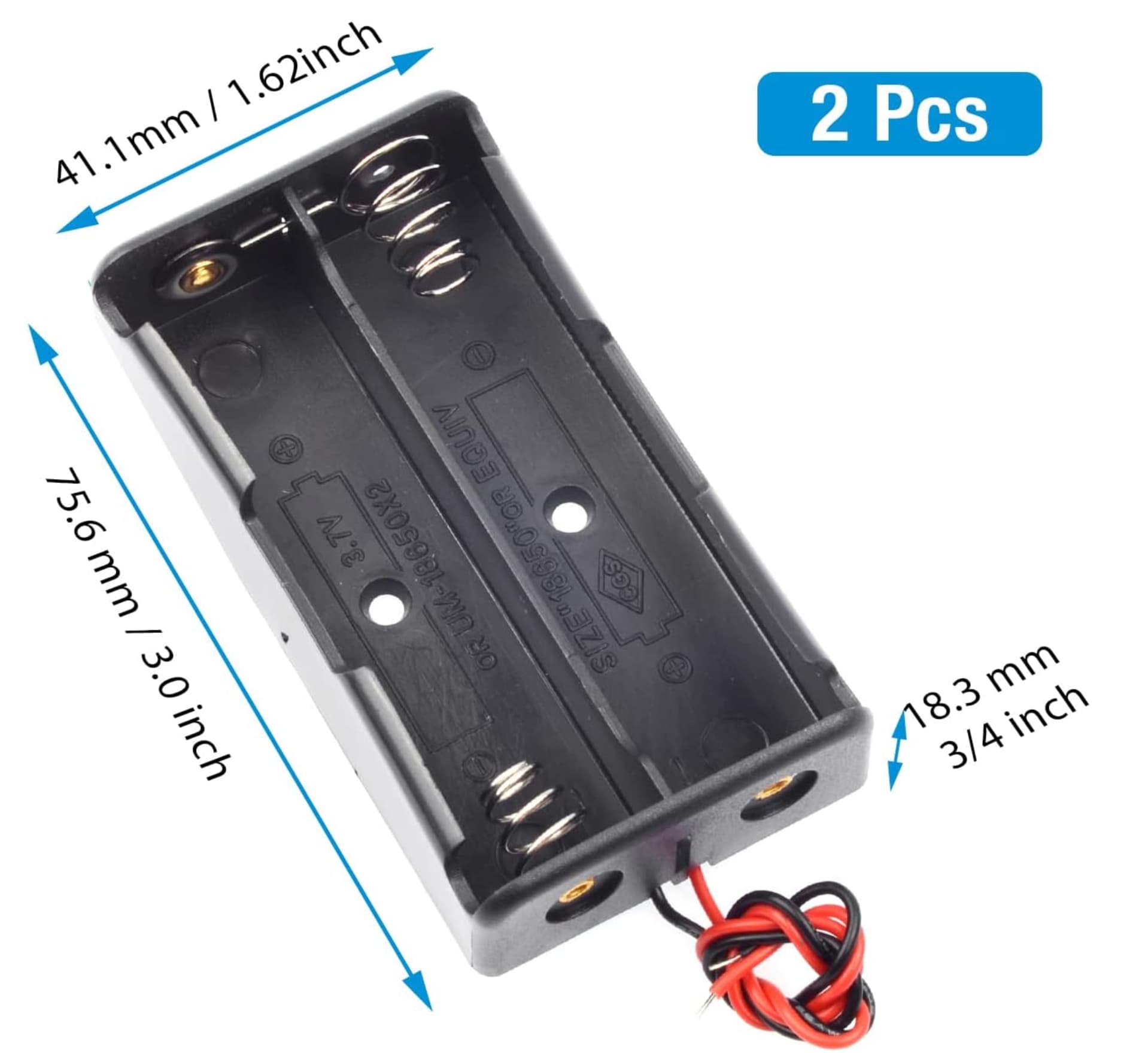

So I am thinking maybe
Would this work?
Can I use even 3-4 batteries in 1 pack?
Theoretically, the battery box you provided is compatible with the batteries. However, you can only connect a maximum of two batteries in series; connecting three or more batteries in series is not allowed. Additionally, if you choose this type of battery box, it is recommended to use top-button batteries instead of coin-cell batteries, as coin-cell batteries may not make proper contact with the metal pieces in the battery box.
