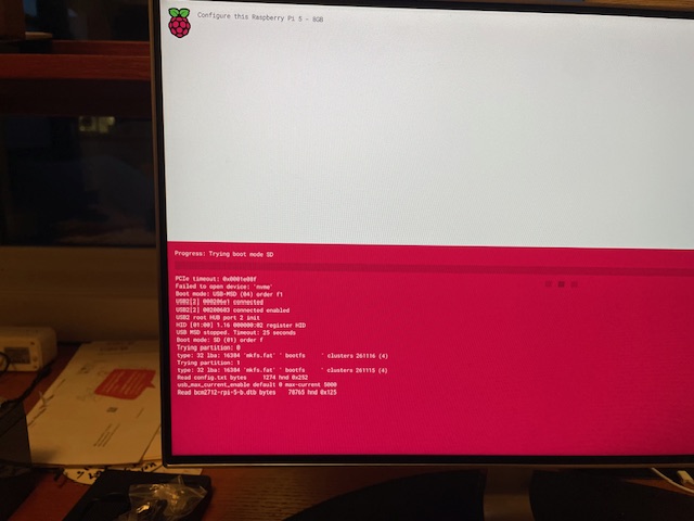

I booted the Pi from the SD card to confirm that the HAT+ would recognize the drive prior to trying to boot from it. It did not recognize the drive. Power light on but status light never lights up nor flashes.
Error messages: Failed to open device:’nvme’

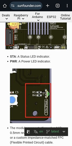

Did you try with a different nvme? Did LEDs are ON on nvme module? Ribbon is well connected? Did the RGB LEDs works?
I did not try another NVMe as I don’t have one. The PWR led is on but the STA light never comes on. The RBG lights all work.

correct no flashing light on HAT+

I have used the Pi Imager to install the OS on the SSD using my PC as the SSD is not recognized on the Pi. I followed the instructions for using raspi-config to set the boot order to tru SSD first and rebooted the Pi. It took longer to boot up as it was waiting for the SSD to be recognized - it did not.
I tried but as a new user the forum is not allowing me to attached a video of the boot up.
Pretty boring anyway, the power light on the Pi and HAT are steady on. Nothing happens until the failover time expires then the power light on the Pi blinks as it boots up. The power light on the HAT remains steady on and the STA light in off the entire time.

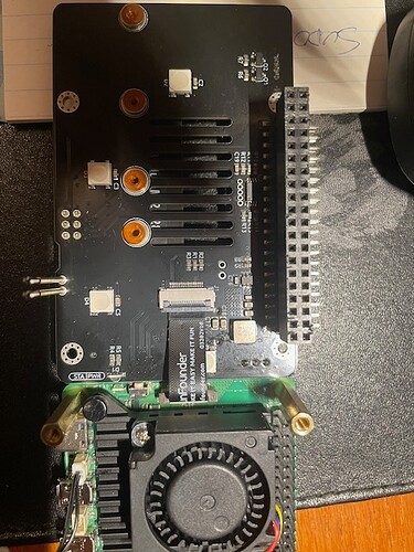

At this point, there’s not a lot of possibility, faulty nvme hat, bad connection between raspberry pi and hat or nvme drive compatibility. You can buy a low-cost nvme on Amazon to test it, after you can return it before 30 days. If nothing works after that, contact sunfounder for a replacement part at service@sunfounder.com .

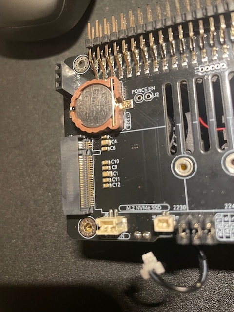

Can you take a photo of cable between RPI and hat? And maybe take a look if there’s damages or bad soldering on nvme module, close to PCIe socket, …
Here is the photo requested.
The nvme works and is on the compatibility list so unlikely the issue.
